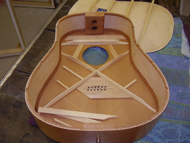

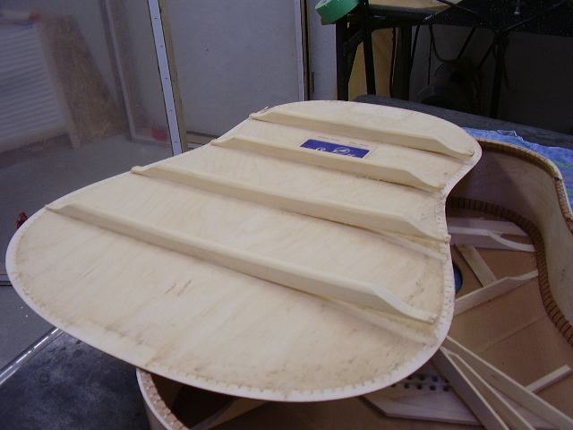

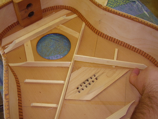

Well, there comes a time when it's just the right thing to do to do work for free. My in-laws have some good friends who's father passed away this past year. He was a flat-picker in a little town bluegrass band near Calgary, Alberta. Well, the night he died, his basement flooded and soaked nearly everything in there, including his Seagul 12 string. Now, I know that this guitar has very little actual value to it, especially when it was submerged for 10-12 hours. But this guitar has real sentimental value to the family (especially the grandson, who is getting married this summer), so my Father-in-law and I are going to repair it.
Here are the pics.
Lots of work, should be fun.

Rod that is mighty nice of you and your father-in-law. Lots of work but it doesn't look insurmountable. I have a Seagull folk guitar that I keep at our summer place in Canada. I love that little guitar. Looking forward to pic's of the rebuild.
PostPosted: Sun Mar 12, 2006 3:36 am

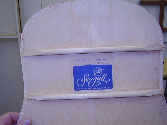

Wow the maple looks very good and pretty much unstained for having been through the wringer. good job separating the back. I can't believe Seagull does a three piece x brace. All separations look clean. makes the repair easy. Well Rod I will let you get after it.

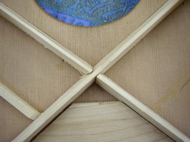

My first piece of advice is to take off the old X brace and toss it - now I see why almost all Seagulls after a couple years start to deform - the X has no strength to it at all using a butt joint. Make a new X, use the same dimensions, but finger joint the crossing, and put a reinforcing cap across the X arm that is cut. It will be WAY better.
PostPosted: Sun Mar 12, 2006 7:52 am
Posts: 575
It gives you the chance to improve upon things, that's for sure. I'd re-brace the top with all new, really nice bracewood. Make the X-brace the way it's supposed to be. You can make yourself a smaller bridge plate as well, and considering that it is a 12 string I'd make a "musser brace" too. This would allow a smaller bridge plate, while helping keep the top flat. A little extra mass won't hurt a 12 string, either.
For the buck, Seagulls are actually pretty darn nice guitars. But I have my doubts that this one would have lasted for many years- but after you re-do it, it probably will.

Doesn't look too terrible- all the parts are there. I'd say take it all apart and
glue it back together. It'll probably turn out better than new.

Thanks guys for the encouragement. I agree, I don't think it will be too difficult of a repair. I just need to convince my father-in-law to pull the top bracing and bridge plate (more like bridge plater if you ask me) and do it right.
I think he'll go for it.
PostPosted: Tue Mar 14, 2006 7:58 pm
I'm with Mark, excellent opportunity to replace and rework! The X-brace looks horrible. Just tell the Father-in-law what the experts at the OLF suggested!
